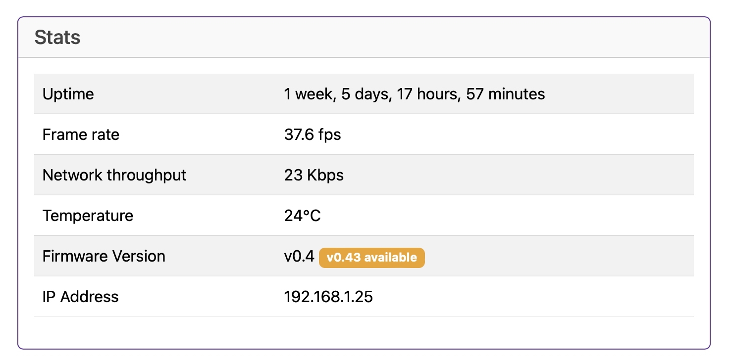

The Stats board gives you a heads up as to what's going on with your controller.
This lets you know what the FPS (Frames Per Second) the controller is currently outputting.
The BaldrickDMX is pretty new in the world of controllers and we've got a LOT of features left to add, this will let you know your current version and if there is a version to upgrade to.

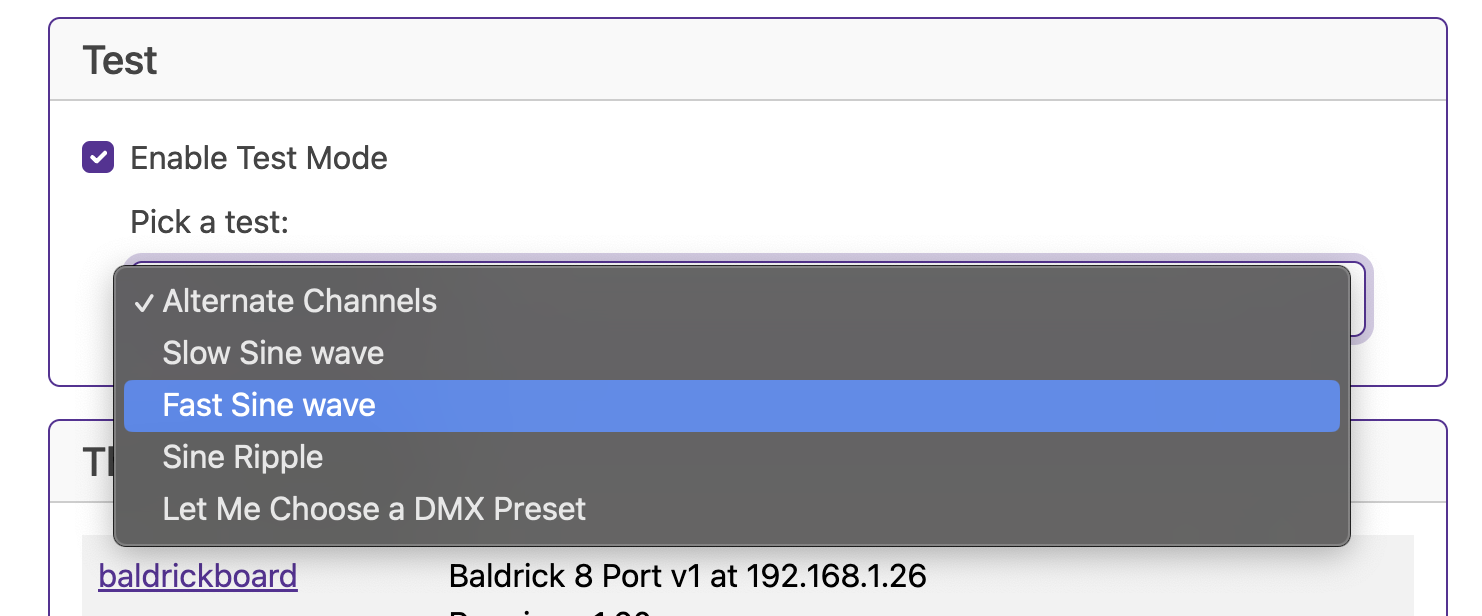

Test Mode allows you to, well, test the board.
BaldrickDMX Web Interface Test
Test Patterns
Alternate Channels
Alternates between channels for testing individual DMX outputs.
Slow Sine Wave
All channels start at zero, go to 255, and back to zero in a slow sine wave pattern.
Fast Sine Wave
Same as slow sine wave but at a faster speed for more dynamic testing.
Sine Ripple
Creates a sine wave that moves across channels over time, each channel moving between 0 and 255.
DMX Preset
Allows you to select a DMX preset that you've created as a test mode.

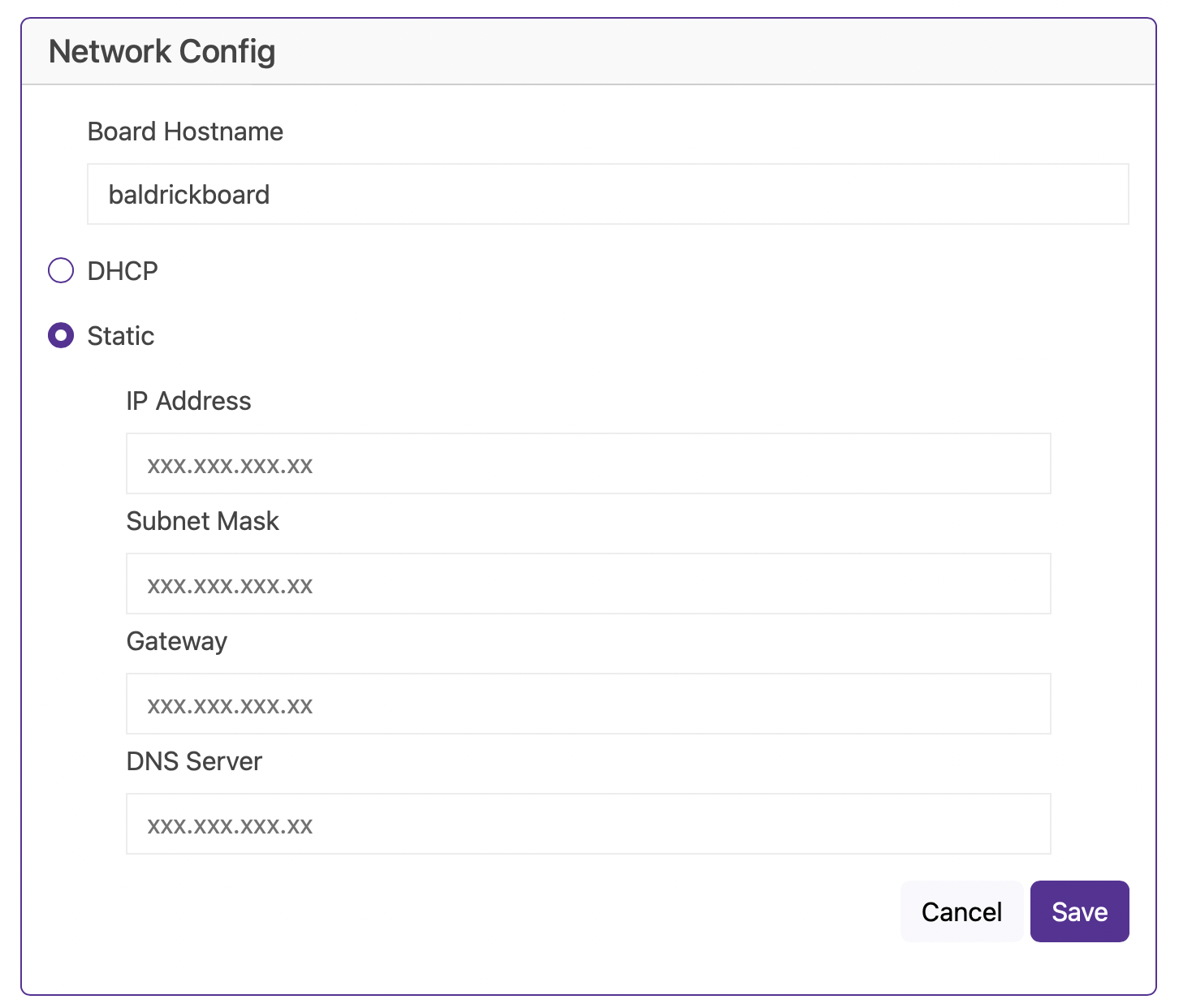

The default hostname is baldrickdmx (hence baldrickdmx.local). If you have one BaldrickDMX then it's completely fine to keep this as it is, however if like us you want to collect a few of them, then we'd recommend you change this to something like frontgardenor upstairsroof
The default option is DHCP (which is Dynamic Host Configuration Protocol but you don't need to know that) which basically means your router or computer gives the board an I.P. address. This is great for initial setup but when you want to run a show it's best to switch it to STATIC, that's where your controller tells the router / computer "This is my IP".
DNS wise, typically, your default gateway is your router IP, and that more often than not, can provide your network with DNS. However, some people like to use "outside 3rd parties" DNS like google or cloudflares DNS. If you don't know about this, its probably best just to stick to DHCP.

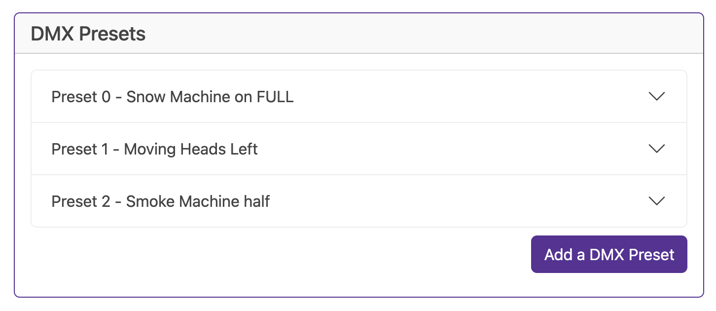

The BaldrickDMX lets you define Presets of set channels and values that can be used either in a test mode or via an action over the Turnip Network.
Adding a Preset
Add a BaldrickDMX Preset
When you add a preset, you are asked for the channels and a value, you can add as many channels and values as you like.
The channels input takes comma separated values such as 11,16,19,21but also can take ranges such as 100-150this will include all the numbers between 100 and 150 (including 100 and 150).

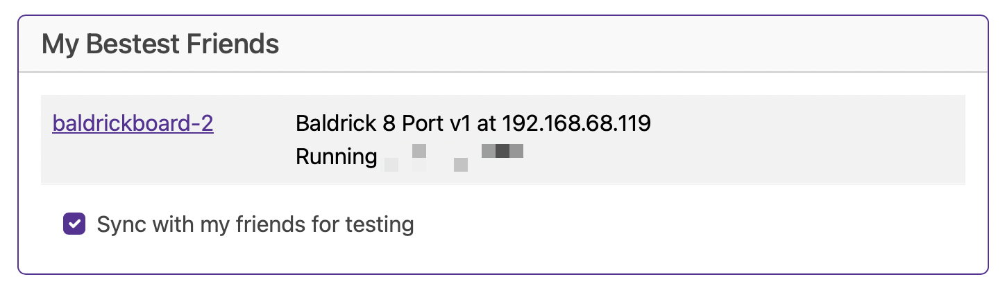

The BaldrickDMX will keep an eye out on the network for other Baldricks and let you know how they are doing (this is helpful as we don't put an LCD screen on the board).
Test Sync
Ticking this box will sync the test mode between all compatible boards, meaning if you are doing something on the house and want all your baldricks in Test Mode, it's very easy to do!
