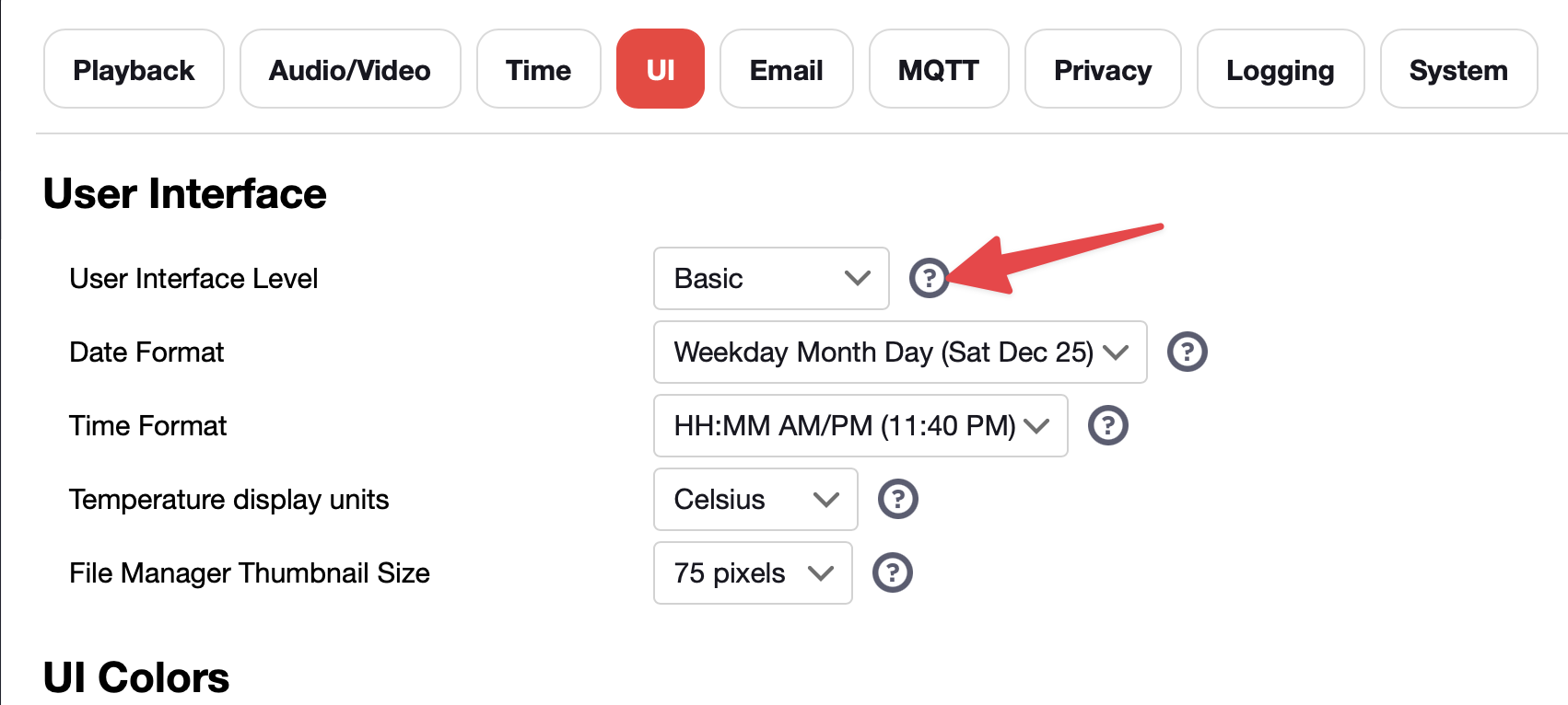

Firstly you need to enable the Advanced UI by going to Settings > UI > Interface level and switching that to Advanced.
FPP Advanced mode

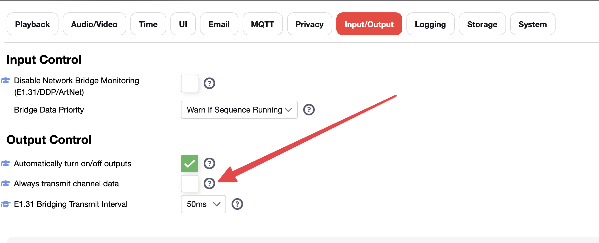

Then head to the Input / Output tab and tick the box which states "Always Transmit Channel Data"
FPP Constantly Transmit
This means FPP will keep outputting data to the pixels even if there isn't a sequence playing.
