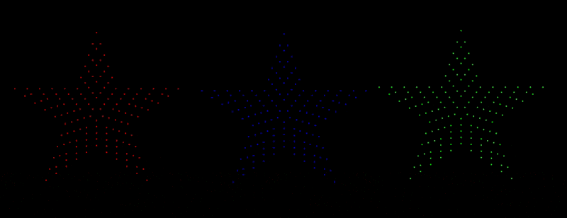

The Hodgical Test is a mode on the Baldrick Board which allows for easy debugging of pixel and model issues.
The Hodgical Test runs the RGB cycle on each model on a port but each subsequent model starts with the subsequent colour.
You can see here these three stars on the same port.
- Star 1 starts with RED, then goes GREEN then goes BLUE
- Star 2 starts with GREEN, then goes BLUE then goes RED
- Star 3 starts with BLUE, then goes RED then goes GREEN
If we had a star four that would go RED then GREEN then BLUE
