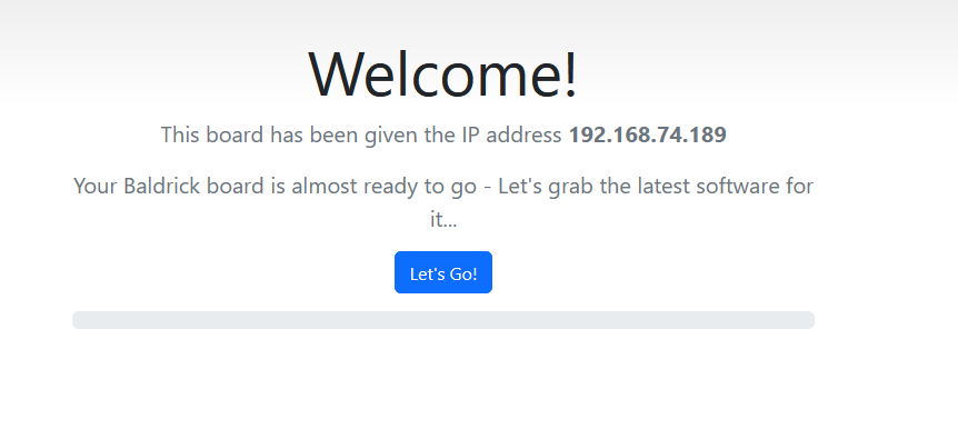

When your controller arrives it will be in a 'sleeping state' you just need to plug it into your network and head to http://baldrickswitchy.local (if your DNS doesn't accept that then just look for it on your network)
First Firmware
How to install​
To put it simply, press the button that says Lets Go then go and have a brew, the controller will connect to our server, download the latest firmware and automatically install it, once it's done the page will refresh and you can start connecting devices.
