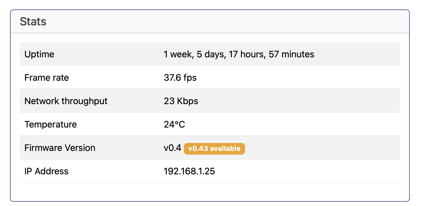

Stats
Baldrick8 Web Interface Stats
The Stats board gives you a heads up as to what's going on with your controller
Uptime​
Frame Rate​
This lets you know what the FPS (Frames Per Second) the controller is currently outputting
Network Throughput​
Like the FPS, this gives you an indication of the volume of network traffic passing through the controller, this should help with debugging
Temperature​
With a sensor next to the Ethernet connector, this gives you an indication of the board temperature (in Celsius) because water freezes at 0, not 32.. how does that make sense?
Generally, PCBs and components are good for -40 to +85°C, Anything below 60°C on this board is fine and nothing to worry about. If the temp is above that, try blowing on it like you would a hot chip out of the oven.
Firmware Version​
The BaldrickDMX is pretty new in the world of controllers and we've got a LOT of features left to add, this will let you know your current version and if there is a version to upgrade to.
IP Address​
