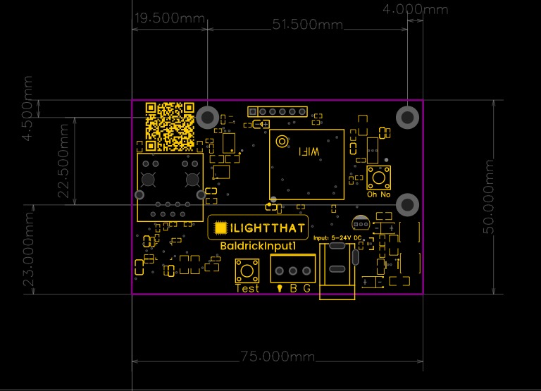

Small​
We've designed the Small so it can be hidden inside a small junction or project box.
Small Baldrick Board Dimensions

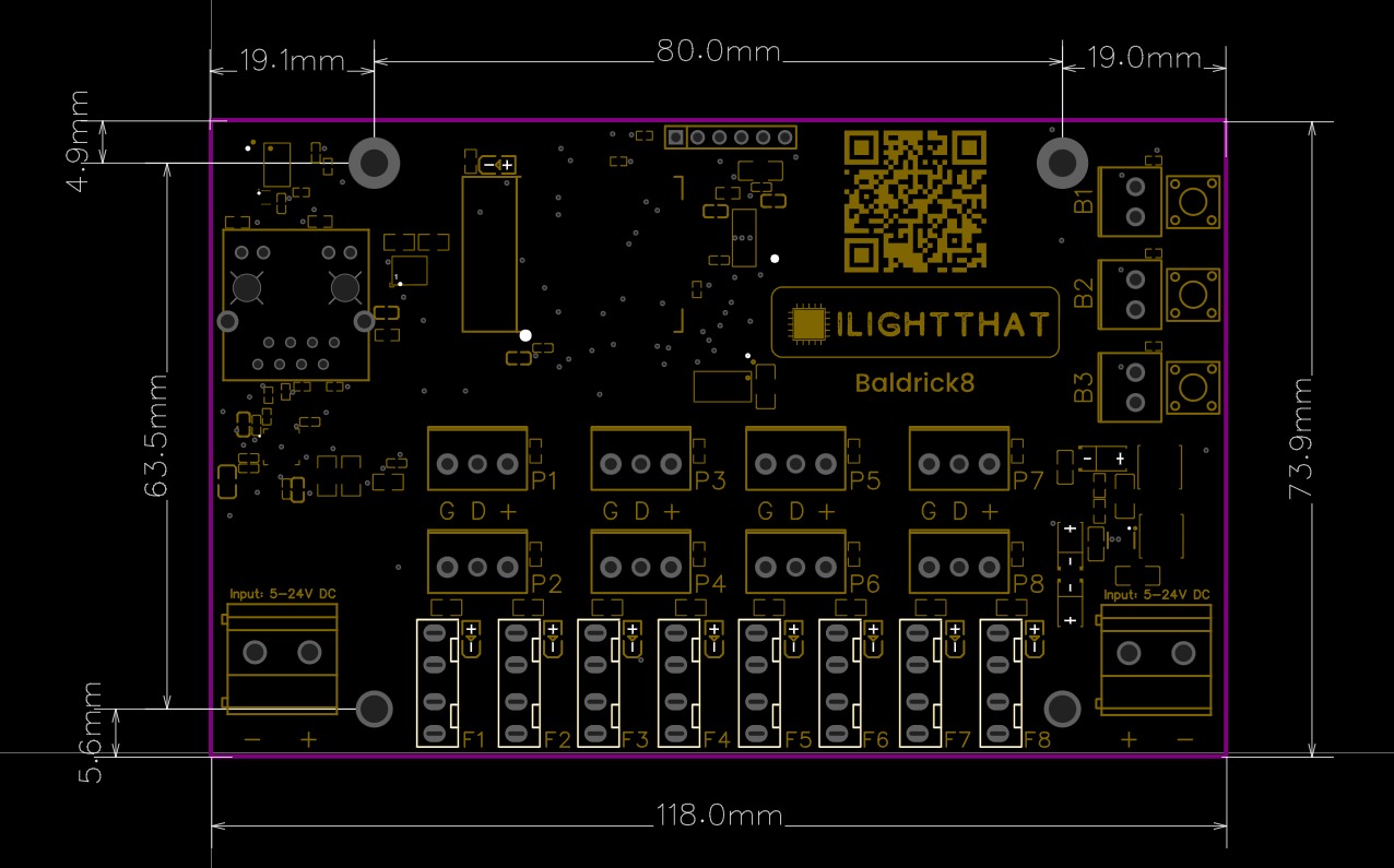

Medium​
We based the dimensions of the Medium Baldrick boards to match similar boards already in the market so you can reuse mounts and 3D printed elements.
The Baldrick community have created an amazing range of mounts and STLs that you can print and use today.
The board footprint is just 117mm by 74mm.
Medium Baldrick Board Dimensions
Once again we ask DO NOT ENLARGE THE MOUNTING HOLES
