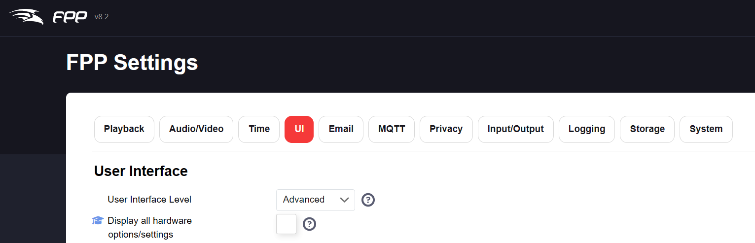

First up, we need to ensure your UI is set to advanced.
FPP Advanced mode

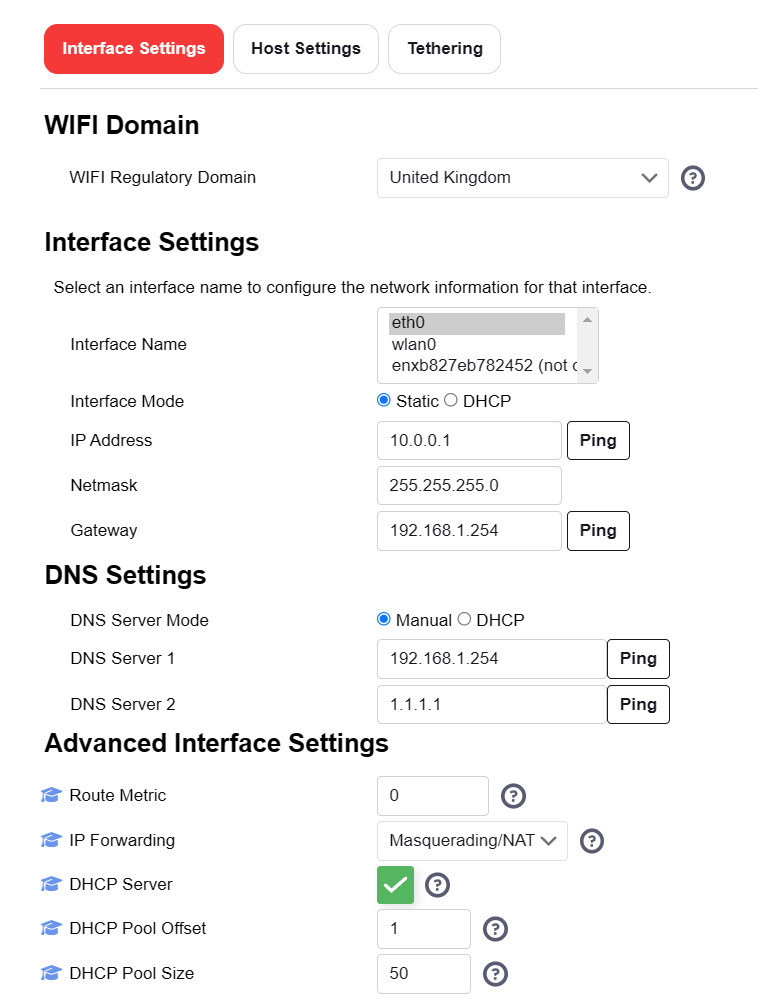

Then under Network Configuration (eth0) give it a static IP outside your regular range and setting the Gateway and DNS as your regular WiFi router. I set IP Forwarding to Masquerading/NAT and enabled DHCP server:

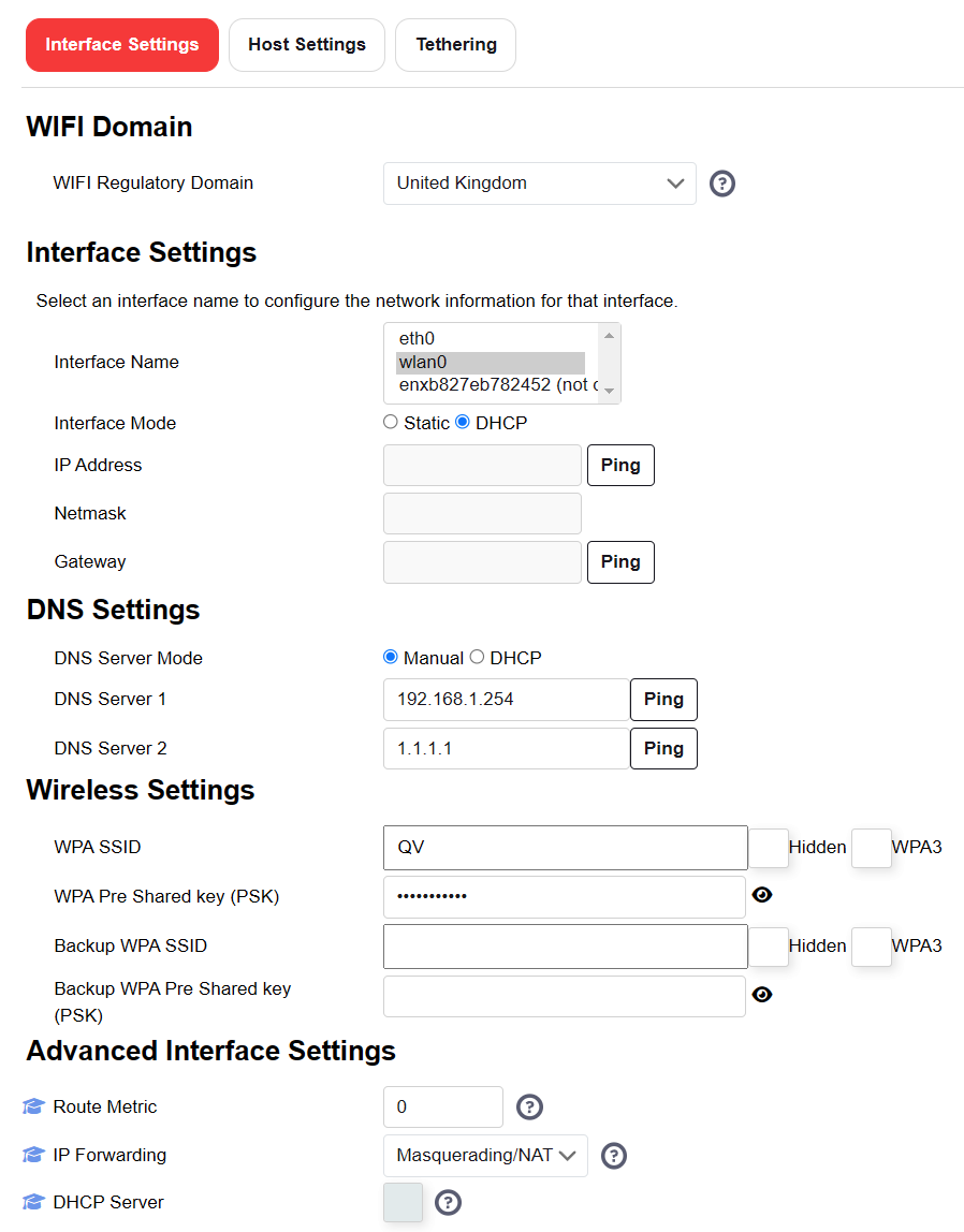

and then on Network Settings (wlan0) I left it on DHCP, but ensured the DNS remained on manual with the settings as above I set IP Forwarding as Masquerading/NAT once again.

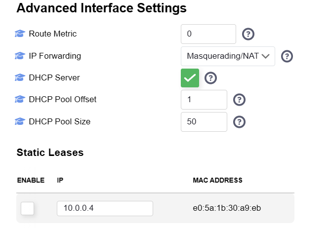

A few moments later, I checked the Network Settings / Eth0 and It has seen the Baldrick and assigned an IP address to it. I could then check the Enable box to set a DHCP reservation (so it doesn't move IP's).

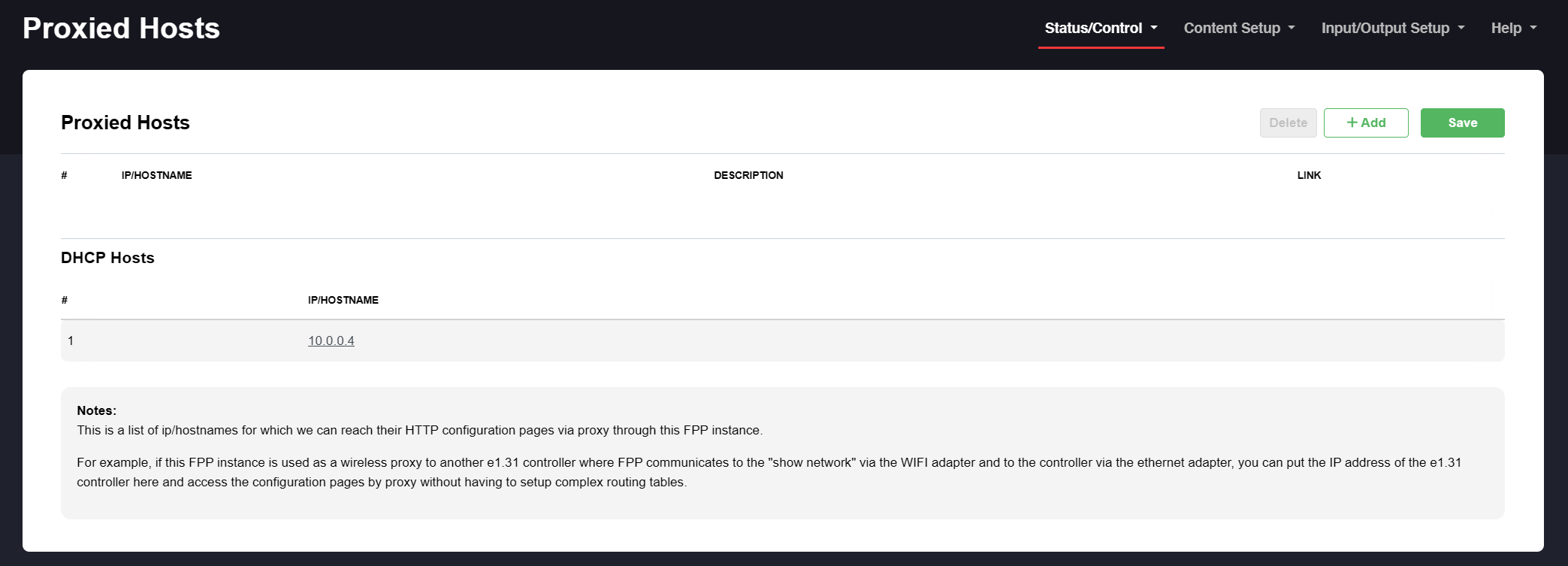

With that active, I could then go to Status/Control, Proxy Settings and under DHCP hosts was an entry for the Baldrick:

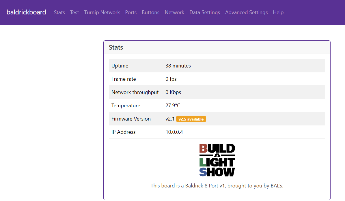

Click that link and up comes the Baldrick webpage.
FPP Advanced mode
That is telling me that v2.5 is available, so that shows it has internet connectivity.
